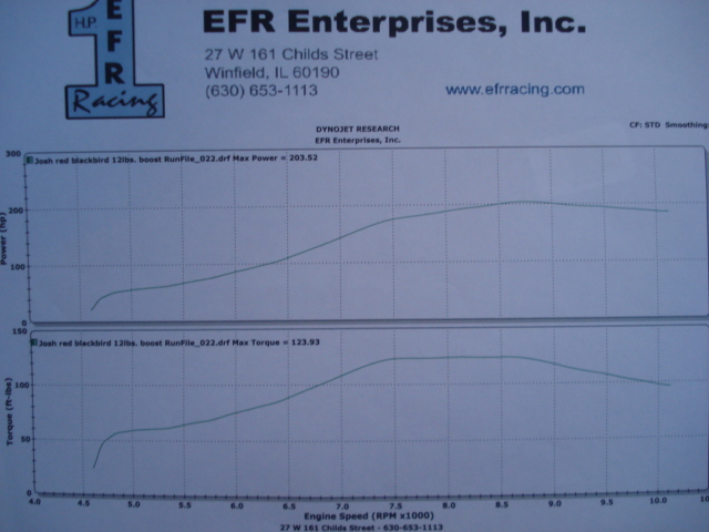

JB4XX Posted November 29, 2007 Posted November 29, 2007 It is a hahn kit with some custom parts from EFR racing www.efrracing.com I had it installed in October so I have only been riding it for a month or so and only put about 6-700 miles on it so far. neil has the same basic setup on his bike Quote
R1000 Posted November 29, 2007 Author Posted November 29, 2007 Interesting... Which stage is it and what was the cost? Was it a comlete bolt on kit? Was there a thicker head gasket included etc. Quote
JB4XX Posted November 29, 2007 Posted November 29, 2007 basically bolt on. you must find someone to tune it right. I am still running stock compression, stock injectors but high flow fuel pump. HanksXXX has a carbed bird he used a thick head gasket to lower compression. XX4me and Elixxer have turbo built motors. I could get 30-40 more hp if I used a dump pipe and opened up my lower for bigger air filter/intake. I am running around 204rwhp at 10lbs of boost pump gas (93 octane or higher) Quote

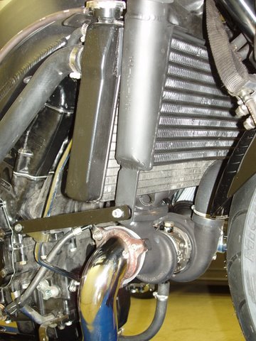

R1000 Posted November 30, 2007 Author Posted November 30, 2007 Short progress report - I've got a lot of good pictures from HANKSXXX that has a very clean turbo installation on his bird. I've decided to follow that concept as much as possible. I've also been in contact with MCxpress and am awaiting prices for the different parts. Below is a pic of Hanks turbo set up. I'm quite surprised that all stuff including an air cooler fits within the stock fairings. It has to been some real 3D thinking behind to achieve this. I've just asked a guy for the price of a low mileage bird engine that he has. It would be nice not to have to use the excellent engine that is in the bike right now and start the project from scratch in case something goes wrong. Whatever happens, the bird is not meant to be garaged during season... Quote
HANKSXXX Posted November 30, 2007 Posted November 30, 2007 Fair enough Dean...I understand the problem, but that is where the carbs on the BB shine. The vacuum chambers on a stocker are joined together and a hose goes to the airbox. On my setup, the same hose goes to the plenum. The float bowls on a stocker are paired and each hose , IIRC, goes to the airbox. Perhaps they just go to atmosphere, I really can't remember...In any event, those 2 hoses go to a pitot tube in the charge or intake tube. Thats it...all thats required... With entirely stock carbs and all stock jetting, the Air-Fuel showed 11.2/1 at 10-12 lbs boost. That could be a bit leaner, but it's a safe operable range and has done well for 5000 miles without even looking at a spark plug. The A-F trace would make a lot of FI guys envious. BTW, Power Commanders scare the shit out of me...I'm an old school guy. Tuning, for me, is a box of brass, not a keyboard. I'm sure that after hours on a dyno with a sniffer and a guy who really knows his stuff, FI can be more accurate than carbs. That just kinda takes the fun out of it. Take it easy...Hank Quote
