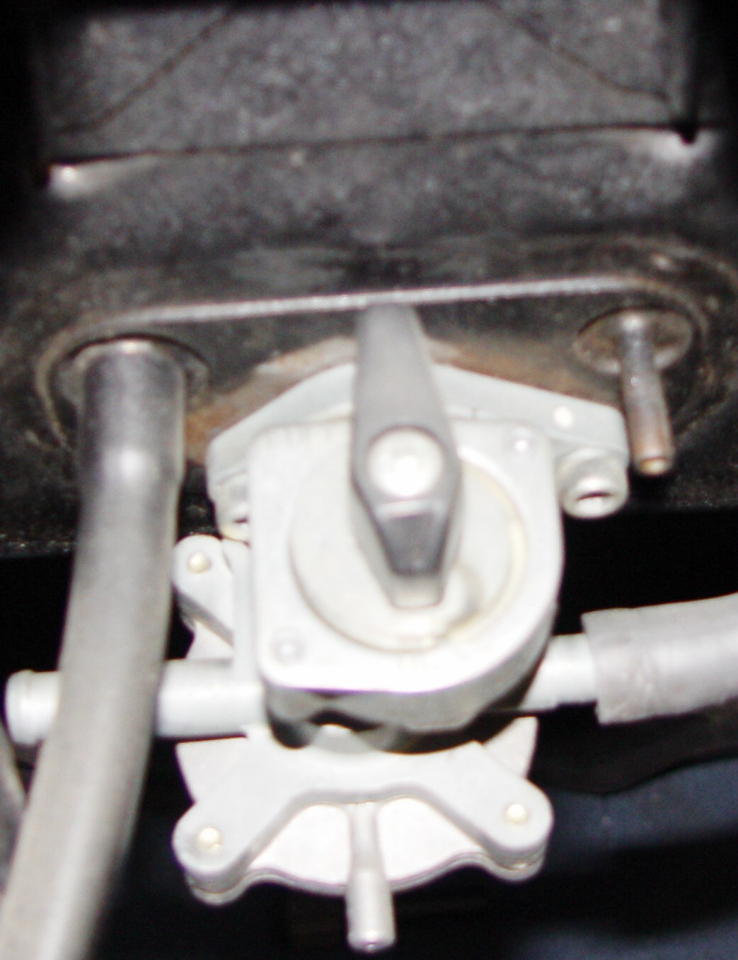

I just received my new spark plugs (and a new battery) so I'm getting ready to do the install hopping to get my bike to run as it should. I seem to remember from a while back that there was a post around here that explained, with a picture/schematic the exact location of the vent tubes plus the on/off location of the petcock. As much as I've searched I've been unable to locate the post. Please point me to it if you have it!!

No drawings, but here it goes. The vacuum line from the head ( just below the #2 carb ) goes to the port on the front of the petcock. Nothing goes to the port sticking straight down from the petcock. On is the pointed part of the knob pointing down to on. On mine the over flow and vent tubes just hang down.

the fuel petcock is in the on position in this pic.
the fuel won't run out of the tank without a vacum source, also if you lift the rear of the tank you can see the petcock

Bingo for Jason ! Getting ready to do the install, thank you very much kiwimack and airborne for your inputs!
